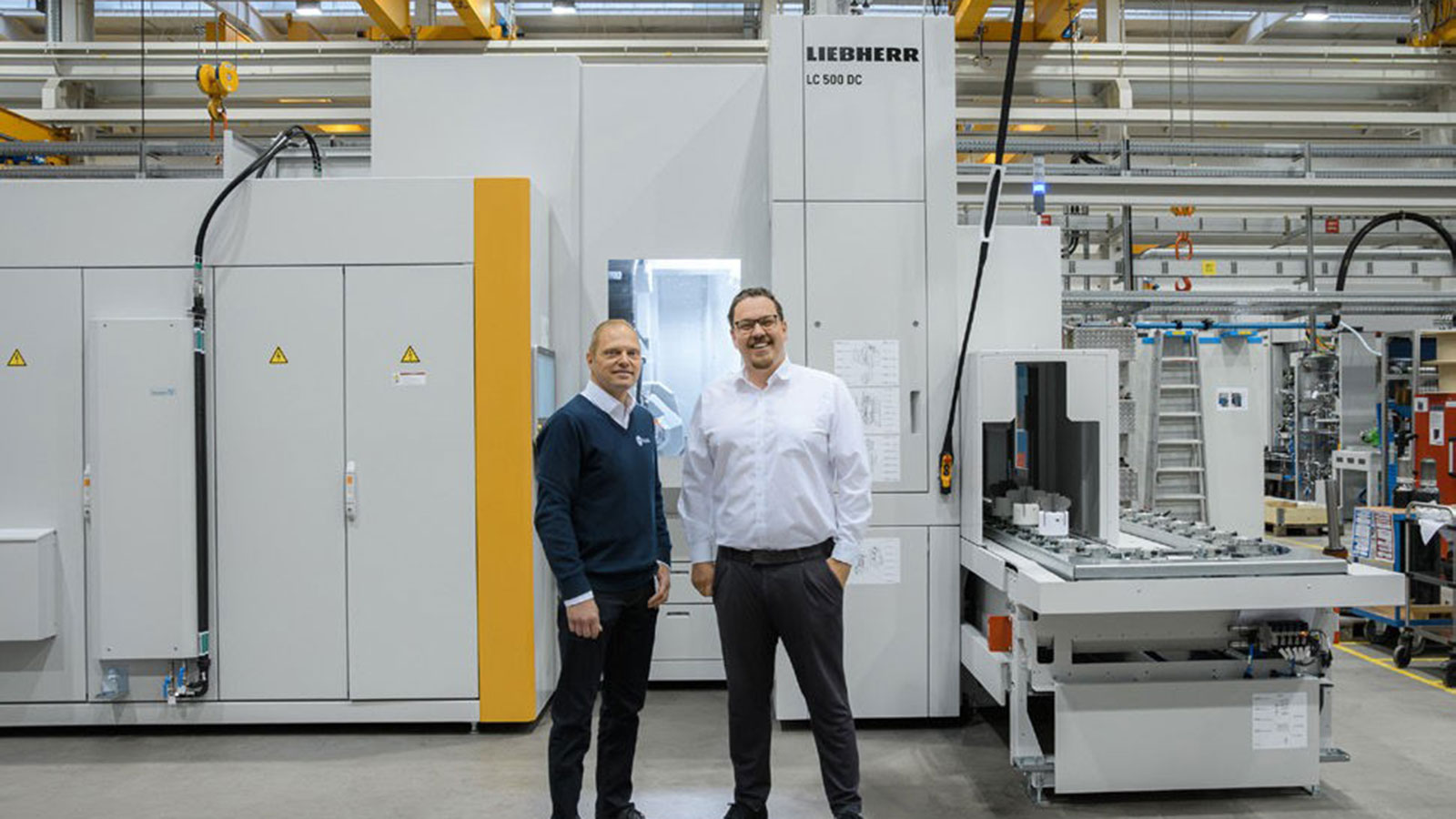

Due to increased order volume for a large agricultural machinery manufacturer, an LC 500 DC was added to SPN’s machinery in April 2024. The decisive factor in their decision to purchase it was the integrated machining unit, which combines two chamfering technologies in one machine—a special feature of the new generation of machines. In addition to the fast, economical ChamferCut process, FlexChamfering—chamfering with common end mills—is particularly attractive for SPN, as it is suitable for small batch sizes. The flexible LC 500 DC enables a wide range of gears up to a diameter of 500 mm to be manufactured with cleanly, reproducible results.

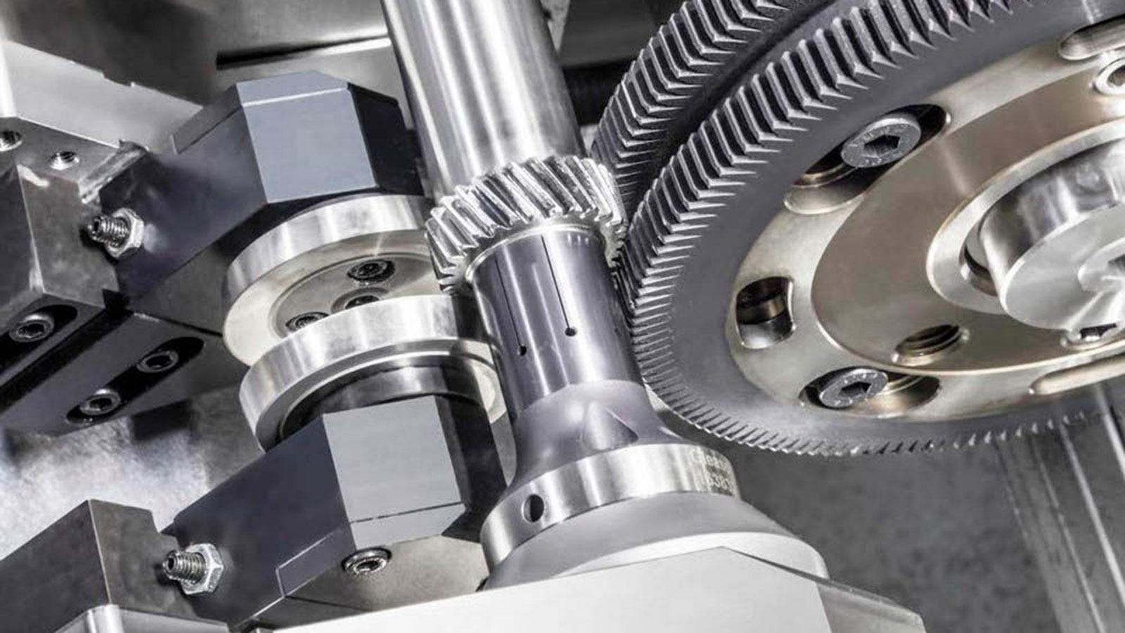

The 100HCD Hobbing and Chamfering Machine is enhanced with a CNC chamfering/deburring station which works completely in parallel to the actual gear cutting process: productivity is not compromised by the chamfering process. Radial Chamfering allows for universal chamfering of gears – and even geared shafts with interfering contours – at comparatively low tool costs.
